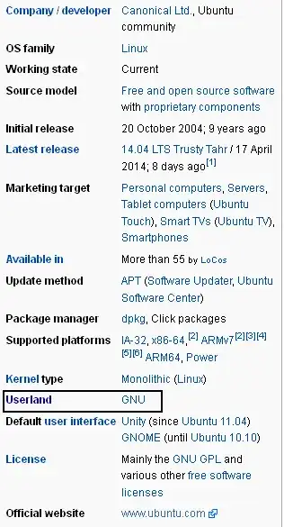

You can see User-land "GNU" from Wikipedia- .
wikipedia
So, GNU commands are available for Ubuntu. To see available commands, see List of GNU Packages.
And for particular command (Ex : find): findutils from GNU Project
