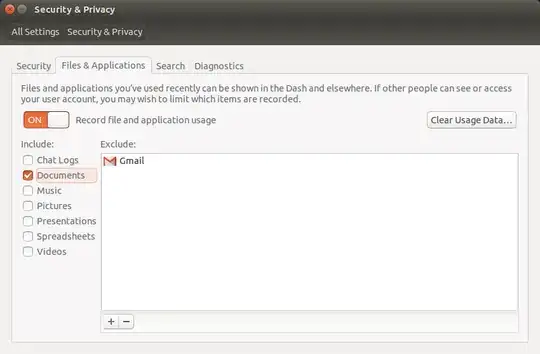

An easy way to reduce the logging (but not the heavy resource and disk use) is via the control panel: enter image description here
Unfortunately little about Zeitgeist is well disclosed or clear. Zeitgeist is not easy to disable, nor is it easy to see what it's doing. You can't "stop" it like other background system services.
