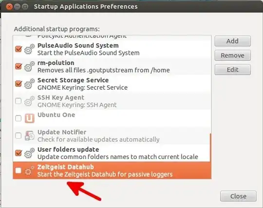

First open startup applications and UN-tick zeitgeist from startup automatically.
description
If you don't see zeitgeist in startup applications, open a terminal (CTRL+ALT+T) and issue the following command
sudo sed 's/NoDisplay=true/NoDisplay=false/g' -i /etc/xdg/autostart/zeitgeist-datahub.desktop

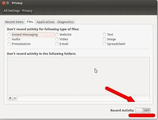

Turn off Record Activity
Open Privacy settings and turn off Record Activity. enter image description here
