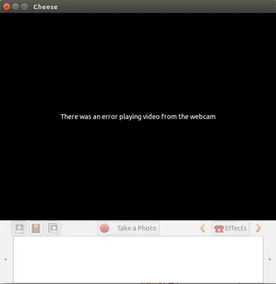

Cheese Booth shows an error:
There was an error playing video from the webcam
Cheese Booth

Please tell, what is the issue in cheese booth.
Note: Sometimes the cheese booth works fine but most of time not

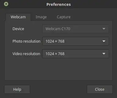

  1. Open Preferences, and change these resolutions to the lowest.
2.Now restart cheese.
3.The webcam should work. Keep increasing the resolution until it stops working again.For many webcams, this limit is 640x480.
