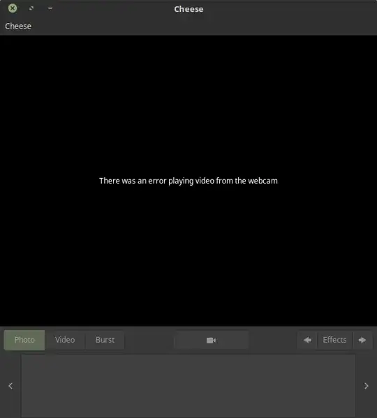

In recent versions of Ubuntu and in some computers, Cheese keeps saying:
There was an error playing video from the webcam
A bug was reported in Launchpad, which has not been solved.
The external webcam in my system is Logitech C170.
For some reason, the default picture resolution in Cheese is set too high for some webcams.
2.Now restart cheese.
3.The webcam should work. Keep increasing the resolution until it stops working again.
