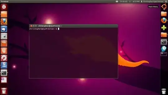

Our goal is to get a second launcher on the right, as pictured below:
Picture of the desired result

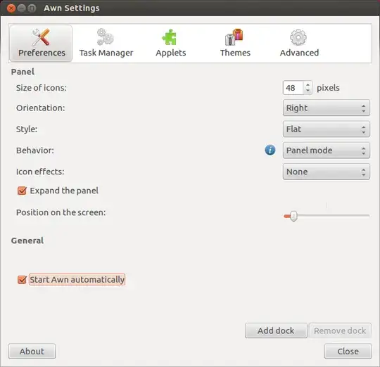

Now start AWN Settings by searching for it in the dash, and let's start setting up the second launcher.
You'll get a window like that below:
AWN Preferences
Change all settings to those shown above.

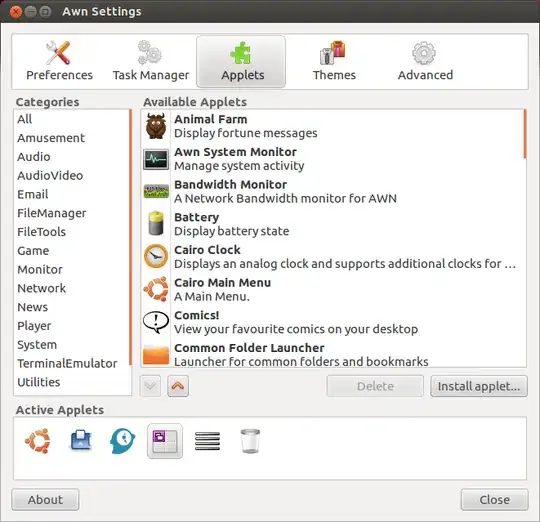

Next, go to the Applets screen. We'll be using the below configuration (but feel free to modify as you please):
AWN Applets
The applets, from left to right (the ordering matters), are:
  • Cairo Main Menu
  • Launcher/Taskmanager
  • Related applet
  • Shiny Switcher
  • Expander (Needed to keep the previous applets near the top and the trash at the bottom)
  • Garbage

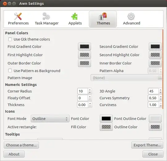

Next, go to Themes and select the Dark Theme. We'll use this as a base for the exact look we want.
Click the Customize button near the bottom of the window to enter this view:
AWN Themes
There's a lot of tweaking to do in here. Here are the following changes you need to make (note: I listed colors as a hexadecimal value, or "Color name", and Opacity):
Panel Colors
  • First Gradient Color: #000000, 170
  • Second Gradient Color: #000000, 170
  • First Highlight Color: #000000, 0
  • Second Highlight Color: #000000, 0
  • Outer Border Color: #808080, 100
  • Inner Border Color: #000000, 0
Tooltips
  • Font: Ubuntu 11
  • Fill Color: #000000, 170
  • Outline Color: #FFFFFF, 100
Extras
  • Arrow type: Triangle

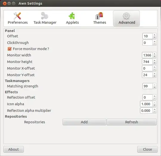

In case you're wondering: nope, still not quite done yet! There's some extra settings we need to take care of to position the launcher correctly; otherwise, it'll run over the menu bar at the top of the screen.
Now go into the Advanced screen:
AWN Advanced
Make sure Force monitor mode? is checked.
Now, make sure you set the following settings to what I've described below. If you don't know what your display resolution is, you can easily look it up by searching for "Displays" in the dash or System Settings.
  • Monitor width: Your actual monitor width in pixels
  • Monitor height: Your actual monitor height in pixels, minus 24
  • Monitor X-offset: 0
  • Monitor Y-offset: 24
For good measure, we should also set Reflection alpha multiplier to 0 while we're in here.

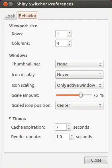

Almost done! We have a couple applet tweaks to make, if you decided to keep the Shiny Switcher and Garbage applets I suggested above so they're more like regular Unity. To enter the preferences for either applet, right-click it and select Applet Preferences from the pop-up menu.
Shiny Switcher Preferences
Check that the settings are the same as those pictured (the colors selected are #000000, 255):
Shiny Switcher Preferences Look
Shiny Switcher Preferences Behavior
