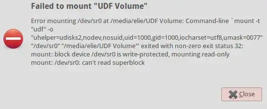

I'm on Xubuntu 64 bit 14.04. When I had windows 7, I burnt a CD, it was like 4 months ago, now I need to open that CD in Xubuntu, since I no longer have windows.
Solution 1 (didn't work)
sudo apt-get install libudf0
Solution 2 (didn't work)
sudo chmod 777 /media
PS: I won't try ashish's solution unless someone confirms that it will work because mojo706 said that it didn't work.
Solution 3 (didn't work)
▶ sudo mount -t udf /dev/sr0 /cdrom
mount: block device /dev/sr0 is write-protected, mounting read-only
mount: /dev/sr0: can't read superblock
dmesg output
Lynob
  • 6,775
I got this and could manually mount the disc as iso9660 instead of udf. I think a recent update in Ubuntu must have change the default for dvd media
sudo mount -t iso9660 /dev/sr0 /mnt
