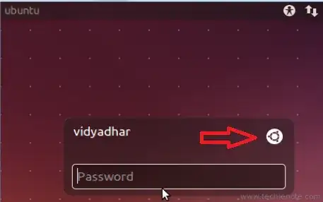

Step 1 : To get started, press Ctrl + Alt + T on your keyboard to open Terminal. When it opens, run the commands below to enable Gnome session
sudo apt-get upgrade
sudo apt-get install gnome-session-flashback
Step 2 : Restart and on the logon screen, click the option to change your session.

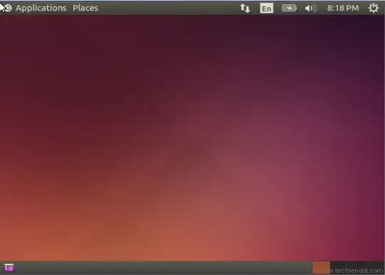

Step 3 : Then choose GNOME Flashback (Metacity)
Enjoy your Desktop

The document you refer to, is many years old. In modern versions of Ubuntu, there is a small button next to your user name. When you click it, you get a list of sessions to choose from.
However, there seems to be a small bug in 14.04 that prevents that list from being shown sometimes. If you select another user and then back to your own user again, it works. I'll update this with a link to the bug report when I've filed on. I just noticed this myself so I haven't had the time yet.
EDIT: I filed it here; https://bugs.launchpad.net/unity-greeter/+bug/1309846
If you have something to add, do it there. If you're annoyed by this bug, click on "This bug affects me" in order to bring the heat up.
