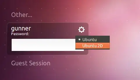

Edit: As of Ubuntu 12.10 this is no longer an option, as Unity-2D was dropped with quantal.
I have the same issues with cpu usage because of compiz. My workaround was to switch session from Ubuntu to Ubuntu 2D.
ubuntu 2d

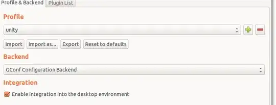

  1. Install compizconfig-settings-manager. Run it by typing ccsm in the dash.
  2. In the application's main window, click on the bottom link with Preference label.
  3. In the Profile tab, click on Reset to default button.
  4. Logout and Login again.
Hope this will help
picture of Profile tab
