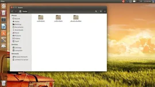

Right now "collin-blatt" has the home icon on it. That is where my files are located by default. I want to delete that and make "collinblatt" the default.

You are making a thinking - error ;)
I assume you have two collin- user accounts: collin-blatt and collinblatt.
If you login as collinblatt, the home icon will be on the collinblatt folder, if you login as collin-blatt, it will be on the collin-blatt folder. That has nothing to do with a presumed "default home directory"; it is always on the current user's home folder.
If you indeed have two user accounts, move your important files to the collinblatt folder and login as collinblatt, remove the collin-blatt account.
If you created the folder:collinblatt manually, remove it, create a new user account (with administrator's permissions) collinblatt, login into the new account, copy the files into the new user's home directory and remove the collin-blatt account from your new account.
The only thing you have to keep in mind is that if you have internal references inside your collin-blatt folder, they will have to be edited, since your username is different. Therefore I would not copy the contents of the folders 1:1, but just move the files.
