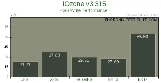

A very good comparison from 2009 on linuxologist.com has a graph about write performance with 4 GB:
write performance comparison from linuxologist
and also has some other information on ext4.
