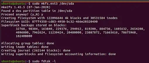

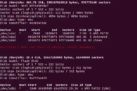

For my case, when I cancelled the installation, I was directed to use Ubuntu on the live bootable flash disk.
  1. I opened the terminal and run
    # fdisk -l
to list all detected hard disks.
Here is a picture of the Terminal window: fdisk -l output
  1. Then I decide to format my hard drive because it had no important data.
    # mkfs.ext3 /dev/sda
  2. I ran the installer again and it worked.
Here is a picture of the Terminal window: mkfs output
