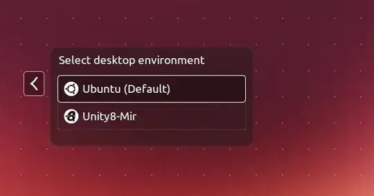

Logging out of Unity 7 should then give both options in the login screen:
