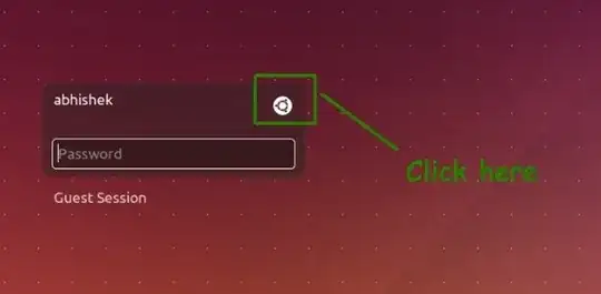

Select Unity 8
From the login screen, click on the Ubuntu icon beside your login name

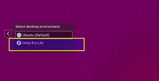

You should see the option of Unity 8 here. Select it:
