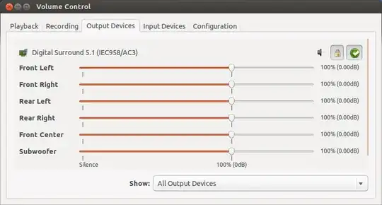

Install Pulse Audio Volume Controller (aka pavucontrol).
Open up your Terminal and execute these commands:
sudo apt-get install pavucontrol # Install
pavucontrol # Run
screenshot of pavucontrol gui

Pulse Audio frontend app (pavucontrol) stripped out balance control years ago for some reason ; use Alsamixer.
sudo apt install alsamixergui
