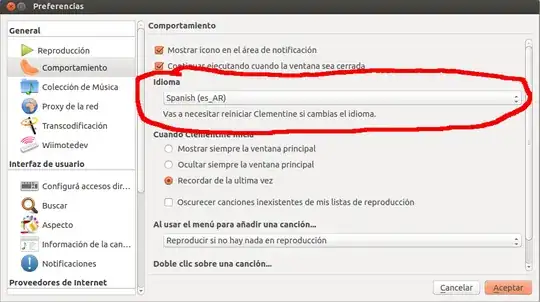

So, it looks like Clementine is assuming the language based on your IP or some other silly method. The good news is that there is a setting for that, at least on version 1.1.1 which is what is in the 13.10 repositories.
Just go into "Tools" => "Preferences" => "Behavior" and change the language:
