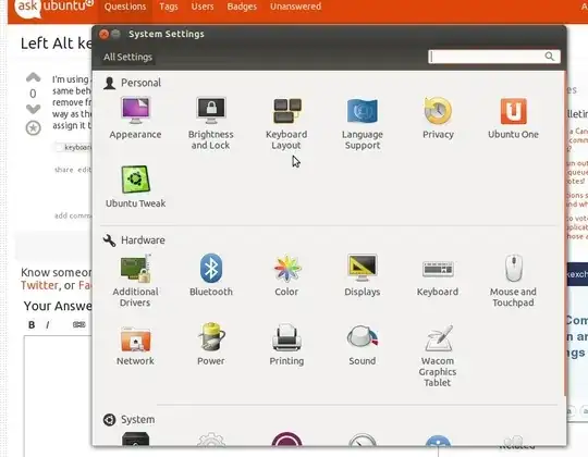

First, select System Settings :
Screenshot 1: open System Settings

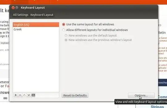

You will be presented with a list of all available layouts. Just press the Options button:
Screenshot 3: click "Options"

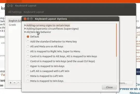

Lastly, from the presented list select Alt/Win key behavior and modify to your needs:
Screenshot 4: "Alt/Win key behavior" list

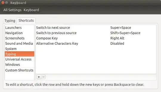

Right Alt is often used as the Compose Key so it may have been mapped to that function. You might solve your problem by looking closely in your system settings, under Hardware > Keyboard (not Personal > Keyboard Layout). Under the shortcuts tab, check and see if Right Alt is used as a shortcut to anything. Here's an example of what that menu looks like on my system, where I've mapped it as the Compose Key.

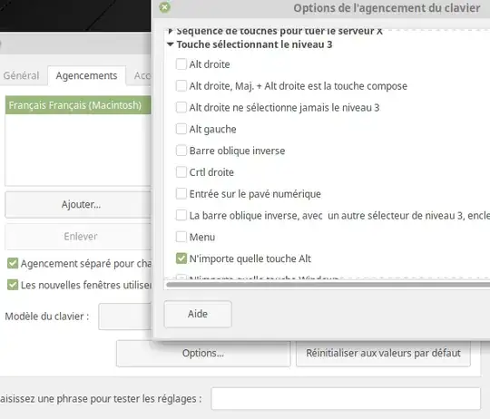

I used the process described in this answer, but instead of "Alt/Win key behavior", I found "Keys Level 3" and checked "Every key alt"
(My Linux is in French, sorry for my poor translation)
