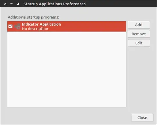

Now, first go to System Settings>Displays and see if your desired resolution is there. This might happen since you just ran the above script with lightdm.conf . If it is so then select it. Then reboot and see if it works. If your desired resolution is not there even now, then attempt the following.
Open "Startup Applications" by searching for it in the dash. You will get something like this :-
Startup Applications window
Then,
  1. Select the Add button.
  2. In the subsequent window type in a name.
  3. Then select the /usr/bin/lightdmxrandr.sh which is the script we created.
  4. If you want you can give a description. Then click Add.
  5. Make sure the entry you just added has a tick mark next to it. Now close Startup Applications.
