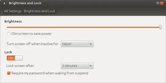

My "brightness and lock" settings seem fine:
I've tried
gsettings set org.gnome.settings-daemon.plugins.power idle-dim-time 600
But that doesn't make a difference - it still dims after 60 seconds, no matter what value I set it to.
I've also used gconf-editor but I don't appear to have /apps/gnome-power-manager/backlight
I'm not using Unity - just the standard Gnome desktop.
Is there any way to change this behaviour? I never want my screen to dim. I'm quite happy controlling it manually with the F1 and F2 keys.
