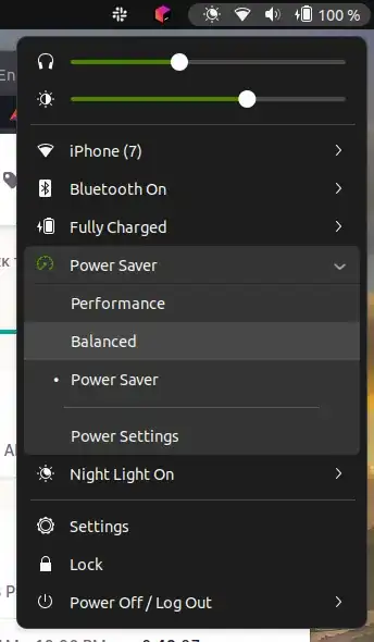

I have a fully charged laptop and mouse battery, so not quite the original problem. However under Ubuntu 22.04, Why does my screen go dim after a while? worked for me.
After precisely 30 seconds, if I had "Power Saver" mode enabled, Ubuntu would dim only the main screen (and not an external HDMI-attached screen) independently of all the other dimmer switches.
Opening the top right menu and switching to "Balanced" fixed it.
top right menu change power saver to balanced
