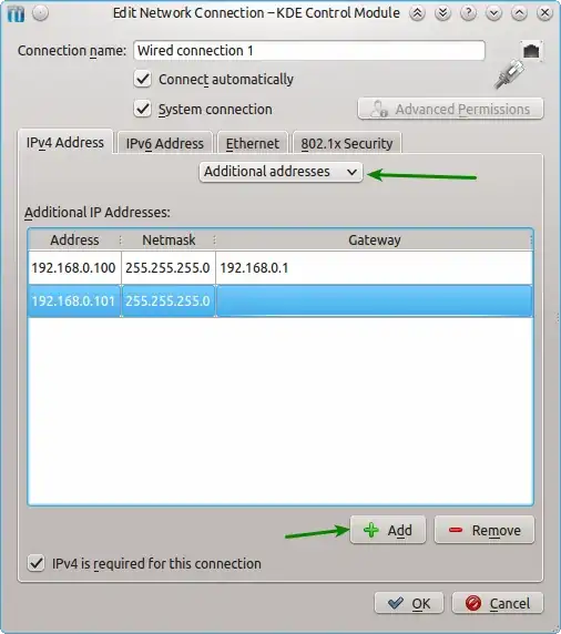

In Network Manager, change the IPv4 settings for the network configuration from "Basic settings" to "Additional addresses" and add as many aliases as you like in the list. See the screenshot below.
While the image is taken on KDE, the GUI should look similar on other desktop environments.

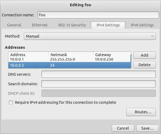

For example, Ubuntu GNOME 14.04:
