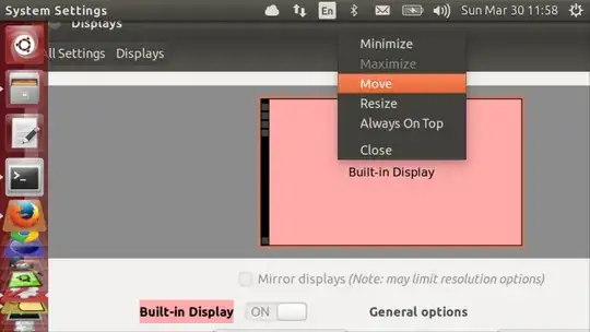

The problem seems to be that you are not able to see/control the lower part of the "Display settings". There is a workaround to move the lower part on top. For this, go to System settings -> Display and then right-click on the window bar on top and click on "Move". Do not move your mouse after clicking on "Move", otherwise the keyboard is not used for moving, only the mouse has the control for moving the window.
right click to move
and then use your keyboard to move the window to top, slowing showing you the lower part where you drag your mouse to reset the scale to 1. Remember to click "Apply" for the settings to persist and then click on "Keep this configuration".
You can also hold down the Alt key and then click on any area of the window to move it up until you can see the slider.

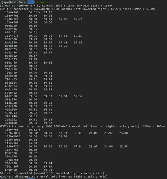

1st of all find that which monitor/display(If you have connected with two or more monitors in case) do you need to scale and it's name according to your machine ?
Using command
xrandr
you will get all informations about your display/monitors. here is mine :
As you are seeing i have connected two monitors and i want to scale my 2nd monitor which is connceted through hdmi and it's called HDMI-1-1.
So to scale i have to use
xrandr --output HDMI-1-1 --scale 1x1
I do not know if the scaling uses the xrandr mechanism. If yes, issue in the terminal:
xrandr --output LVDS1 --scale 1x1
substituting LSVD1 with the name of your active display obtained by running xrandr --current.
More info in this other answer.
