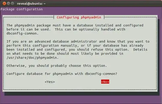

EDIT :enter image description here
here I opted for No, because it might delete database config in phpmyadmin, luckily all database appeared in phpmyadmin after reinstallation.
