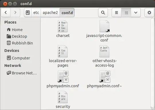

i renamed phpmyadmin.conf link and ran
sudo ln -s /etc/phpmyadmin/apache.conf /etc/apache2/conf.d/phpmyadmin.conf
see the broken link symbol in nautilus:

lrwxrwxrwx 1 root root   28 Jun  9 17:28 phpmyadmin.conf -> ../../phpmyadmin/apache.conf

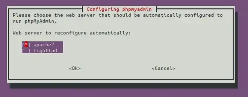

It seems to me that you forgot to tick apache during the phpmyadmin installation screen. You can check if that is the case by checking for the presence of /etc/apache2/conf.d /phpmyadmin file.
You can reconfigure phpmyadmin with the following command:
sudo dpkg-reconfigure phpmyadmin
You will see the following screen:
Choose Web Server
Tick apache (using spacebar), and tab to OK.
