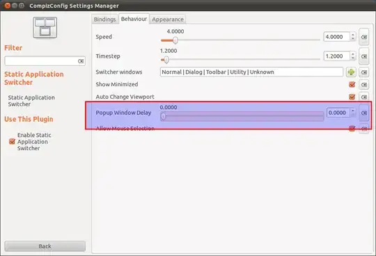

It ends up that there is a delay of 2ms set in the alt-tab switcher (called the Static Application Switcher) by default.
To change it, use you can use CompizConfig Settings Manager Install ccsm. After you install it, run it via the dash by searching for compiz or just run ccsm from alt-f2:
And then set Popup Window Delay to 0 in the behavior tab.
And crank up the speed:

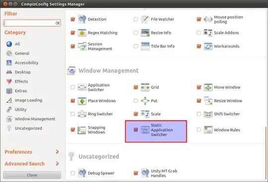

  2. Enable Static Application Switcher
    CCSM > Window Management > Static Application Switcher > Check the box to enable it.

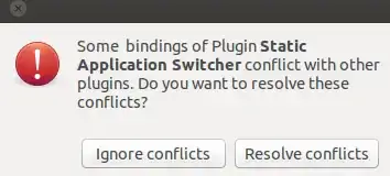

    2.1 You will be prompted with a "bindings conflict" dialogue. Select Resolve conflicts.
    2.2 Now you will be prompted with this monstrosity:
    Select yes to disable any and all conflicts. Which one is yes? The third option, furthest to the right, it will always be the third option furthest to the right.
    You will now get a weird Application Switcher when you Alt+Tab. It will look like you've broken everything. Next we'll configure it.

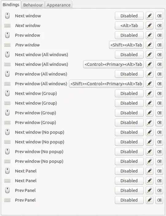

    3.1 Bindings
    CCSM > Window Management > Static Application Switcher > Bindings
    • Ensure the Next window binding is set to Alt+Tab
    • Ensure the Prev window binding is set to Shift+Alt+Tab
    • Ensure the Next window (All windows) binding is set to Control+Primary+Alt+Tab
    • Ensure the Prev window (All windows) binding is set to Shift+Control+Primary+Alt+Tab

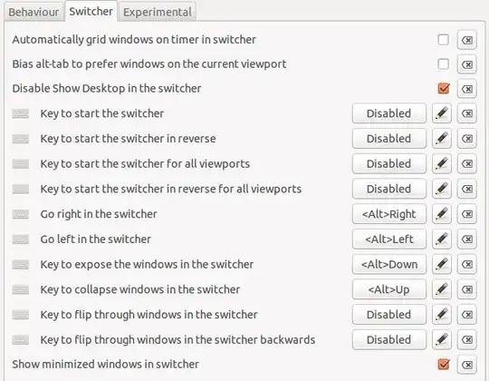

    • Ensure all the binding above are disabled in the CCSM Ubuntu Unity Plugin (UUP). The binding for UUP can be found in CCSM > Ubuntu Unity Plugin > Switcher.
    The Static Application Switcher Bindings should like something like this:
    And the Ubuntu Unity Plugin Bindings should look something like this (notice that the first 4 bindings are disabled, because we're using the static application switcher):

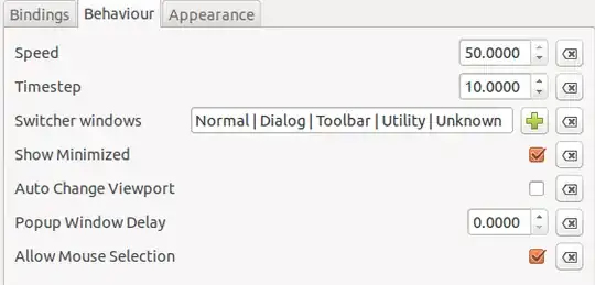

    3.2 Behaviour
    CCSM > Window Management > Static Application Switcher > Behaviour
    • Speed = 50.0000
    • Timestep = 10.0000
      Timestep is how often the window's direction is recalculated. A high timestep will result in windows that overshoot their position and bounce back, and a low timestep will result in windows that drift slowly and accurately to their position. - http://wiki.compiz.org/Plugins/Scale
    • Popup Window Delay = 0.0000

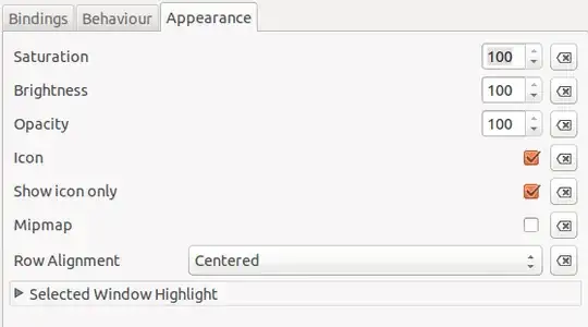

    3.3 Appearance
    CCSM > Window Management > Static Application Switcher > Appearance
    • Show icon only = Yes:Checked
Done! Alt+Tab should be much faster.

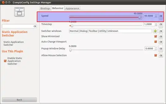

Changing the popup window delay won't change the speed at which the applications switch. On the same settings page as in your answer, change 'Speed' from the default 4 to 1. That sped things up a lot on my setup.

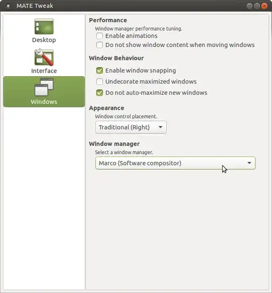

It is the "window manager" that introduces these delays. If you have installed ubuntu-mate-desktop on top of Ubuntu 16.04, you can run mate-tweak to allow selection of an alternate window manager.
For a low-latency experience, try "Marco (No compositor)".
To do this from the command-line run:
marco --no-composite --replace
