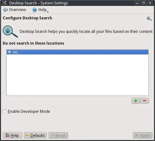

I have Kubuntu 14.04 and just installed the newest updates. Looking at the process list, I see baloo indexer running.
I could not find a checkbox in Baloo settings to turn off the indexing.

There is no explicit “Enable/Disable” button any more. We would like to promote the use of searching and feel that Baloo should never get in the users way. However, we are smart about it and IF you add your HOME directory to the list of “excluded folders”, Baloo will switch itself off since it no longer has anything to index.

As of KDE 4.13.0 (Kubuntu Trusty) it is no longer possible to disable Semantic Desktop in the GUI. Though there is a "Desktop Search" applet in the System Settings, and you should be able to blacklist your home dir there, doing so has no effect and Baloo (who has taken over from Nepomuk/Strigi) keeps doing its stuff with 100% load and multi-Gigabyte memory use on the CPU core it runs in.

(I had my home folder in the "don't search" section, probably from nepomuk, and baloo_file was still using 100% of a core.)

Adding $HOME to the list of excluded paths did stop the baloo_file_extractor, which was using 100% CPU. However it then started baloo_file_cleaner which was trashing my harddisk.
