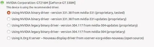

It came out that the problem was that I have OPTIMUS. But in 14.04 it seems to be supported.
So, under 14.04 (on my external HDD) it detects my Nvidia driver OUT OF THE BOX!!! But with Blender and cuda installed as said on this site and this driver:
I then installed Blender from this ppa as well as the CUDA driver from the same site.
Then, Blender detects the GPU!!!

Quick sum up of the issues and their fixes:
  • Optimus not supported by Ubuntu (13.10)
    -> Ubuntu 14.04 supports it out of the box!
  • Blender doesn't detect CUDA
    -> Use the proprietary driver (accessible in the additional driver panel)
  • Blender complains about CUDA 1.2. It only supports >=2.0
    -> Use Blender 2.96 or lower or install the CUDA toolkit
    -> AND use "Experimental" mode
=> It should work! :ยท)
For more informations: https://blender.stackexchange.com/questions/10800/cuda-acceleration-with-cuda-1-2
Thanks to everybody!
