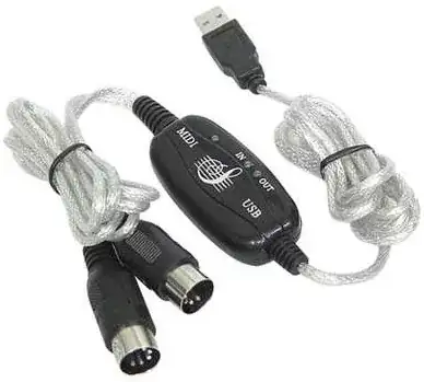

I have a Yamaha P-120 model with a USB to MIDI interface that looks like this.
