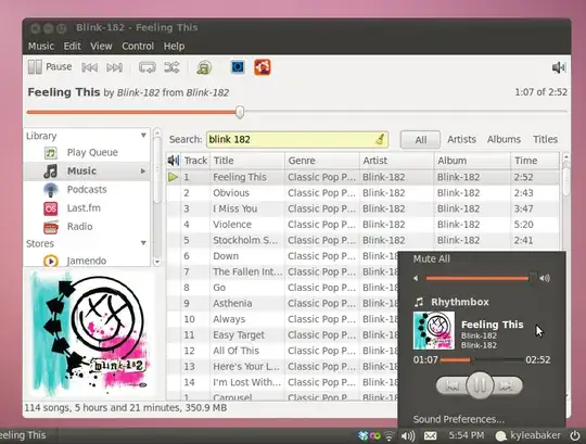

I think it's possible. I found this screen shot here even though it's from 2010 :-)
