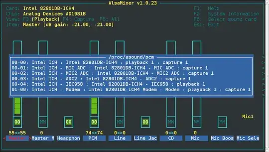

Now having pulseaudio as default in Ubuntu, all these alsa settings are somehow 'hidden'. Following picture shows Alsamixer with some 'F2' option.

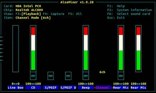

I was able to get my speakers working by changing the "Channel" setting from "2" to "6". Maybe this helps somebody in the future.
Screenshot
