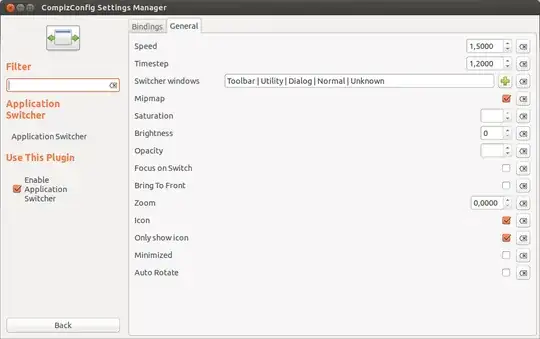

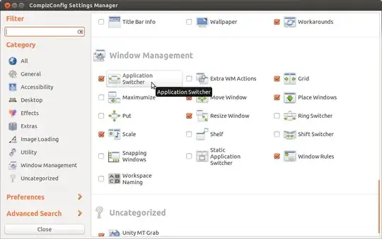

Anyway, if you want more, the behavior about you asked can be obtained using CompizConfig Settings Manager (you said that you have it installed). After you open it, first enable Application Switcher:
CCSM - Application Switcher
Second, go inside to Application Switcher, select General tab and play a little with those options until you get what you wish. Personally, I made the following selections:
CCSM - Application Switcher - General tab

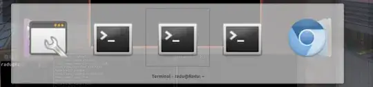

And the result is:

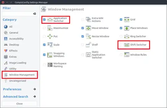

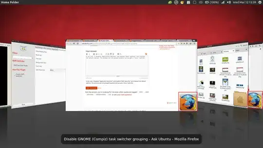

In my case, I disabled "Application Switcher" and enabled "Shift Switcher" and retained the default options. The windows are not grouped anymore and you get a 'fancy' switcher.
In the screenshot below, the multiple Firefox windows are not grouped together.
For this to work, you will have to install compiz-config settings manager and its plugins. Run this command on the terminal.
sudo apt install compizconfig-settings-manager compiz-plugins compiz-plugins-extra
Once they are installed, launch compiz config settings manager and go the section 'Window Management'. Thst's where you find both the "Application Switcher" and "Shift Switcher" options.
See screenshot:
