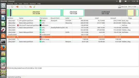

I installed Ubuntu 16.04 alongside Windows, giving it 50 Gb of space. Now, I need more space. I'm using gParted and I managed to unallocate a piece of partition. How can I extend Ubuntu with the space I reserved? Many thanks
This is an easy one...
Backup any data on your Ubuntu partition, as this procedure could corrupt or loose data.
  • Boot to a Ubuntu Live DVD/USB in "Try Ubuntu" mode
  • start gparted from the Unity dashboard
  • right-click on sda8 in the lower pane and select resize
  • hover the mouse pointer over the left side of sda8 until it turns into a directional pointer
  • click and drag the left side of sda8 all the way left
  • click OK to close the move/resize window
  • click the Apply icon
