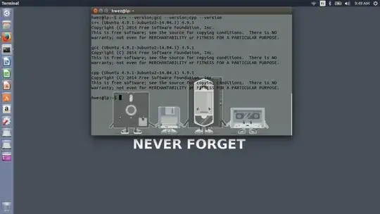

27
install
sudo su -
apt-get install build-essential
add-apt-repository ppa:ubuntu-toolchain-r/test
apt-get update
apt-get install gcc-4.9 g++-4.9 cpp-4.9
after that if you check the version of gcc you will find the old version
gcc --version
so we can fix it with simple symbolic
cd /usr/bin
rm gcc g++ cpp
ln -s gcc-4.9 gcc
ln -s g++-4.9 g++
ln -s cpp-4.9 cpp
or
you can update using update-alternatives
// Actually i tried the symbolic & i know this will work but you may use the symbolic to get it without problems // please correct me if I am wrong
update-alternatives --install /usr/bin/gcc gcc /usr/bin/gcc-4.9 40 --slave /usr/bin/gcc gcc /usr/bin/gcc-4.9
update-alternatives --config gcc
update-alternatives --install /usr/bin/cpp cpp /usr/bin/cpp-4.9 40 --slave /usr/bin/cpp cpp /usr/bin/cpp-4.9
update-alternatives --config cpp
update-alternatives --install /usr/bin/g++ g++ /usr/bin/g++-4.9 40 --slave /usr/bin/g++ g++ /usr/bin/g++-4.9
update-alternatives --config g++
or
you can just compile with
/usr/bin/gcc4.9 filename.c
gcc-4.9 is just like the gcc-4.8 "ubuntu 14.04 gcc" it is not a big deference
