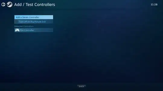

DS4 in Steam
The DS4 seems to have native support in Steam (client from 2016-01-01, tested on Ubuntu 14.04 with HWE kernel and 15.10) and Big Picture Mode works as intended through USB and Bluetooth.
To pair the DS4 in Ubuntu go to the Bluetooth settings and press the plus button (+) below the listing of paired devices to get to the pairing dialog, then press and hold PS+Share on the controller until the LED starts blinking and select the wireless controller to pair once it shows up.
