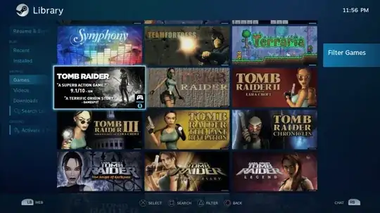

  • If you're using "Big Picture Mode" and you have connected your controller in Steam, it will show a "controller" icon for games which support the DUALSHOCK 4 (refer to "Tomb Raider" in the picture below). Controller icon in Steam "Big Picture" mode
  • Steam will "work its magic" to get the DUALSHOCK 4 working as expected in most games (e.g. PlayStation X for "select"/"accept"/"enter" and PlayStation O for "cancel"/"decline"/"back"), however some games will still show Microsoft Xbox series icons, which may lead to some minor confusion.

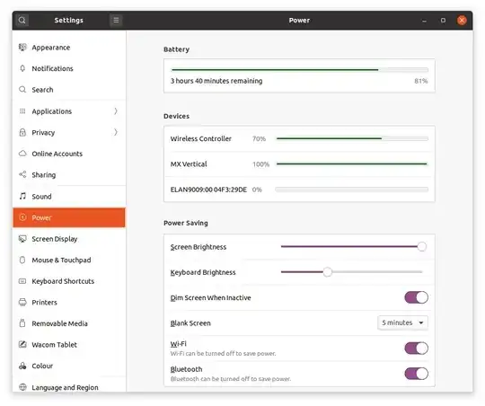

  • You can check the battery status in Ubuntu's settings (under "Power"); if you look in the "Devices" section, you should see "Wireless Controller" with the current battery status listed. Controller Battery
