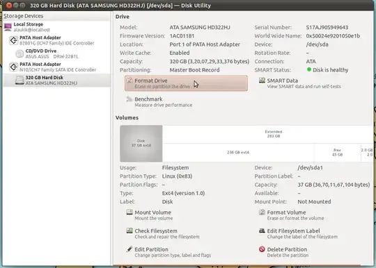

  • Insert the Ubuntu LiveCD into your Mac and Shutdown. Restart the Mac and hold the Option Key. When prompted select 'Try Ubuntu' .
  • Once the system is booted run Disk Utility from the dash .
  • Select your hard disk and click on Format Disk .

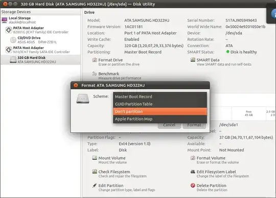

  • Now select 'No Partition' . enter image description here
  • Now install Ubuntu normally .
