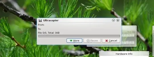

If you want a GUI version try Ultracopier
N.B. in the download section there is a deb file you can download. Remember - the software is very new.
fossfreedom
  • 174,526
Helps you to integrate UltraCopier on the Nautilus/Nemo file browser.
Ultracopier:
Is included on the official ubuntu universe repo and is added as a dependency of the extension, so will be automatically installed.
