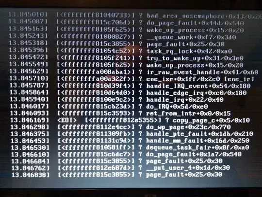

I often get stuck at the boot on battery.
I can suspend and hibernate without any trouble (even on battery).
If I plug the energy cable everything goes right most of the time (edited June 13).
Adding "acpi=off" doesn't solve the issue.
Disabling power save from LAN at BIOS doesn't solve this too.

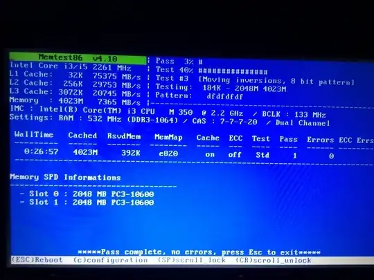

Memory test seems to be ok:

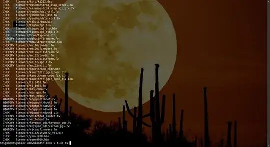

I can even compile a kernel without a problem:

(I have the same questions marks in my mind as the image shows if not more :-/ )

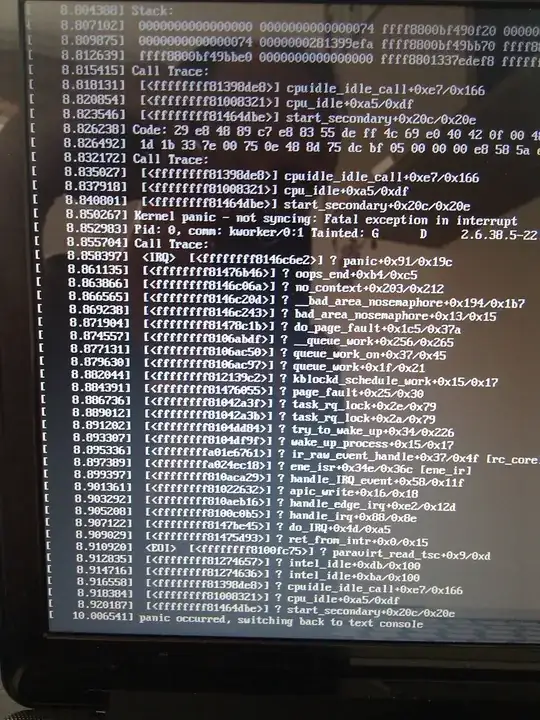

Also I grabbed a Fedora live usb pendrive and got the same problem:
So I think it is a hardware problem related issue.

Have a look inside log file viewer (press super and type "log file viewer") and see if you can find error messages prior to the bad_area_nosemaphore in your screenshot.
bad_area_nosemaphore: one of the causes for this can be faulty memory. That can also explain why you sometimes have a problem: if that bad memory is not touched everything works like a charm. If it does get touch unexpected results can be expected. In general: irregular behaviour during boot always start thinking memory 1st.
So run memtest from the live cd or from grub if you can boot into it and see if 1 of your memory modules is in bad shape and if so replace it.

If this was from an alpha I would do a clean install, but that's my personal choice.
Having said which, looking at the evidence I would say that the kernel is probably trying to determine settings by probing interrupts or loading a module.
Try turning off the acpi in the grub boot parameters.
