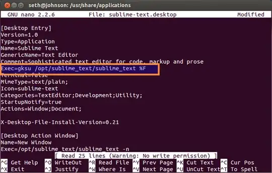

Sublime Text should have a .desktop file located in /usr/share/applications/ named sublime-text.desktop.
Open it and change the Exec= line to include gksu (or gksudo they are the same) at the beginning.
Now unpin and repin the sublime text icon to the launcher.
NOTE: Your path to the sublime executable will probably be different, that's because I installed the Sublime 3 beta, don't worry about it, just add gksu.
