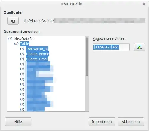

If the file is an XML table, you can open it in LibreOffice Calc through the Data > XML Source menu1. Inside it, you just need to open the XML file, point to the table you're importing on the left column and specify a destination in your sheet in the right text field. Example:
This feature is documented in the Help for LibreOffice Calc and at https://wiki.documentfoundation.org/Development/Calc/XMLSource .
1 Since this is an experimental feature (at least in V 6.1.3.2), it may be unreliable and the menu entry will be greyed out unless experimental features are enabled with ToolsOptionsLibreOfficeAdvancedEnable experimental features.

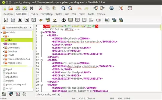

The default Gedit text editor is capable of opening the file - I also suggest you try Bluefish, which can do XML as well HTML and other languages. It also does auto-completion, and highlighting.
Here are examples of the above editors based on this:
Bluefish screenshot
enter image description here N.B. With Gedit, you have to add some of the above by changing a few settings and activating a few plugins.

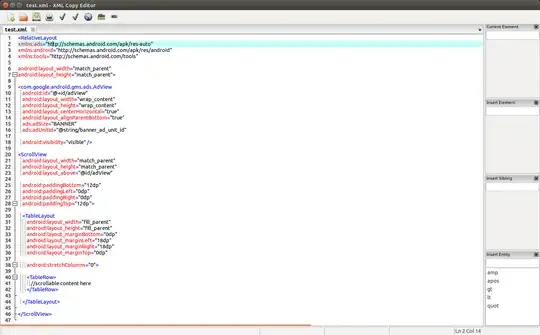

XML Copy Editor (xmlcopyeditor) is a fast, free, validating XML editor. It features DTD/XML Schema/RELAX NG validation, XSLT, XPath, pretty-printing, syntax highlighting, folding, tag completion/locking, and a spelling/style check. XML Copy Editor can be installed from the default Ubuntu repositories.
XML Copy Editor debugger (xmlcopyeditor-dbg) is an optional add-on for XML Copy Editor that can also be installed from the default Ubuntu repositories.
