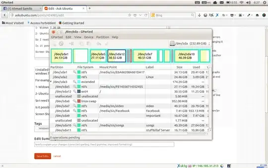

Screen Shot : enter image description here

If parttiton C is a logical drive and Ubuntu and Windows are on different filesystems/partitions then just Format Windows and resize Ubuntu from a different OS than Ubuntu (you can use a live linux burnt to usb for example)
Update: I assume dev/sda5 is Windows and /dev/sda12 is Ubuntu.If something else then the steps to od are the same anyway.
So format /dev/sd5 partition with Windows on it. Then boot into another OS (like live Lubuntu0 and resize the partition with Ubuntu to what you want.
