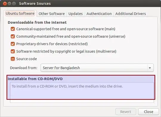

For 12.04 and 12.10
This feature i.e auto enabling of the installation medium as software sources is disabled in this release. The section is empty now by default and will say this:
To install from CD-ROM or DVD, insert the medium into the drive
Here is a screenshot added
I think, this will be continued in the coming releases also.

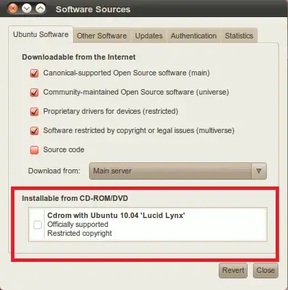

Go to System->Aministration->Software sources. Go to Ubuntu Software tab, at the bottom of the tab there is an option for CD/DVD. Selecting/deselecting it enables and disables CD/DVD as software source. Just un-check this option and your system will not look for Ubuntu CD or DVD
