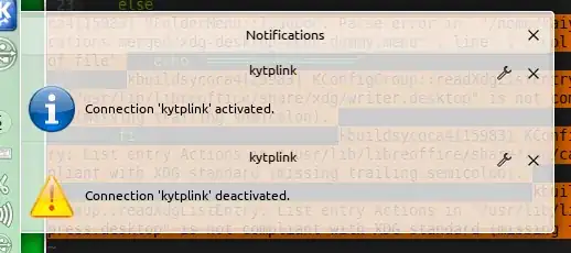

Here is the command:
kdialog --passivepopup 'This is a notification' 55
This command sends a notification at the up-right corner of the screen, with a blue background and white text.
I am expecting something like this:
