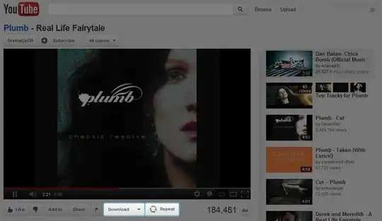

YouTube Center is excellent user script, which works accross browsers, doesn't involve bloating your OS with ton of Youtube downloaders unless you're a strictly 320 kbps person for your audio files. Besides, you have Handbrake at your disposal which involves bit of a manual work but will do exactly what you want. :)
