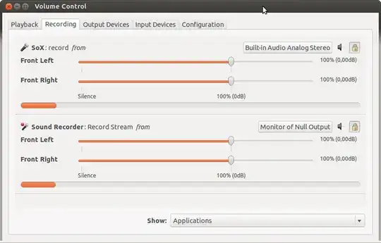

  5. Start pavucontrol.
  6. While you capturing program is trying to capture it will show up in pavucontrol under the Recording tab. Change its recording source from the default to Monitor of Null Output.
    pavucontrol settings
  7. Check the results, it should be working.
