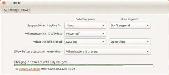

is the power settings under system settings missing because thats where you can graphically set the time
as you can see if you have this which I'm sure you have, then you can modify it.
