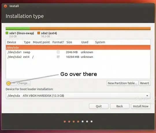

Go to the option 'Something else' .you'll get the partition table.Select the partition you want to install.
Then set the filetype to ext4.Select the format checkbox.Select root '/' as mount point.
Next before installation go to "device for boot loader installation"(see the image) and select the partition you've created just before.then press 'install now'.
After booting with live usb/cd ,Run following command in terminal,
sudo add-apt-repository ppa:yannubuntu/boot-repair && sudo apt-get update
sudo apt-get install -y boot-repair && boot-repair
provided: boot repair
I hope this will help.
