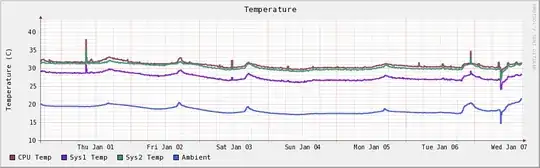

lm-sensors has a daemon, called sensord, that uses RRDtool for 'data logging and graphing system for time series data'. So it includes graphics like this that can be shown through a webserver:
im1
(taken from lm-sensors project page).

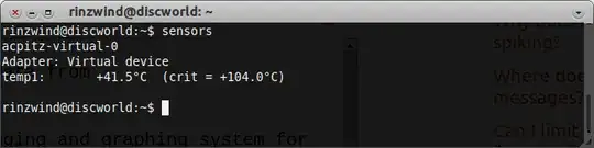

Example from my notebook:
im2
The config file for this is located at /etc/sensors3.conf

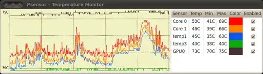

lm-sensors is sort of the basic of any temperature measuring. Desktop items are more than likely to get their information from this package. An example If you want something that depends on a desktop
psensor.
  • motherboard and CPU sensors (requires lm-sensors to be installed).
  • NVidia GPUs
  • Hard Disk Drives (requires hddtemp to be installed).
  • Fan speed (again, requires lm-sensors to be installed).
Installation by adding a PPA:
sudo add-apt-repository ppa:jfi/ppa
sudo apt-get update && sudo apt-get install psensor
(Oneiric will have psensor included)
(old) example from ubuntugeek.com: im6
