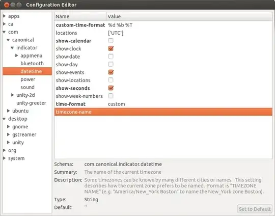

That seems to do the trick for me. You should be able to do the same using dconf-editor.
In dconf editor, it'd be something like this:
