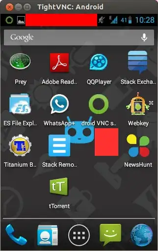

Droid VNC Server
Allows you to remote control your android within your computer.
Note: Your phone must be ROOTED!
Note: Will not work on Tegra3 Devices
On your android Phone:
  • Install Droid VNC Server from playstore.
  • Open the app and click on START.
  • It shows the IP-address and port number. Please note it down.
On your Ubuntu PC:
  • Install xtightvncviewer by running the below command:
    sudo apt-get install xtightvncviewer
  • After installing xtightvncviewer run the below command to view your phone's screen:
    vncviewer xxx.xx.xx.xx:xxxx
    xxx.xx.xx.xx:xxxx - already noted ipaddress:port

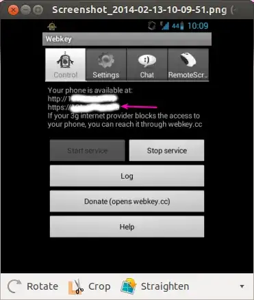

WebKey
Using this application you can control your phone from any browser.
  • Install WebKey app from Play store.
  • Open the WebKey app and select start service.
  • Note down the https link generated.
  • On that same application, go to settings->User settings->Click on Create new user to create a new user with login credentials.

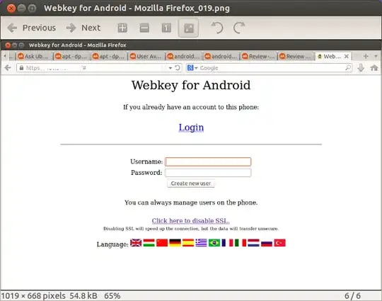

On your Ubuntu PC:
  • Open any browser. I prefer Firefox. Then paste the noted link on the address bar. It display like connection is not secure. Trust the connection and allow it to load.

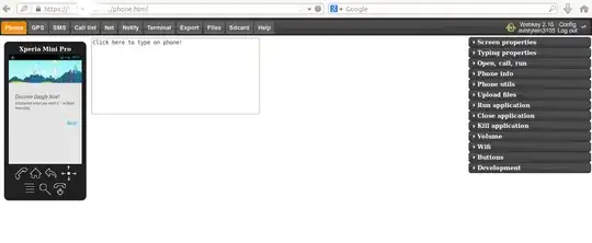

  • After that a page will open and ask you to give the username and password. Login with the same username and password.
  • After loged into your account, you can view your phone and operate your android phone from there.

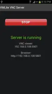

You can use VMLite VNC Server
It's a combination of an Android app, desktop app plus VNC viewer app that will allow you to control an Android phone or tablet from a computer or another Android device!
Features:
  • Control your Android phone or tablet from your computer or laptop!
  • Works in a desktop program or web browser!
  • Possible to project your phone onto a larger screen!
  • Works on non-rooted devices as well as rooted!
How to Setup VMLite VNC Server
  • Install the desktop app from developer’s site here. Learn how to install. Hint: be sure to allow this app through your firewall.
  • Install the Android app.
  • Install a VNC viewer app of your choice.
  • Run the VMLite VNC Server app.
  • Run your VNC viewer app and enter the IP address information from your phone then click “Connect”.
Official and source for further information
